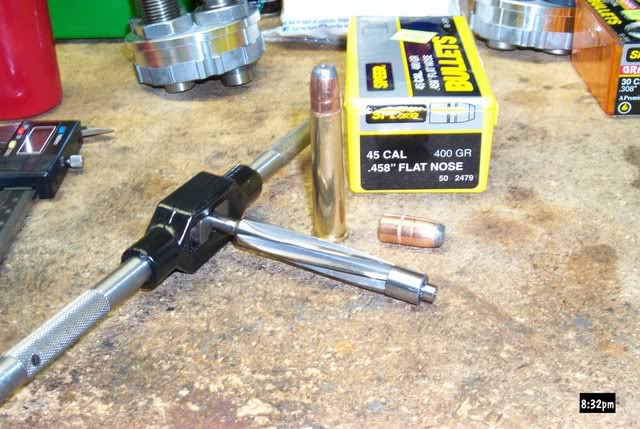

All of my .45-70 barrels now have Linda Lovelace throats, good enough to load the 400gr Speer FN to a COL of 2.575" in the second cannelure. ;D Took about 45 minutes, start to finish for all three barrels including cleanup. Cost was $27.05 plus return shipping for the reamer.
http://www.4-dproducts.com/display.php?group=Throaters&PHPSESSID=407426d105f5e6b3d455cd964f129ccf
Here's a group of bullets that shows why the throating is necessary with most 350gr bullet and all 400gr and bigger bullets unless they're bore rider cast bullets.
Left to right: 300gr Speer, 300gr Rem, 405gr Rem, 400gr Speer FN, 350gr Speer FN, 350gr Hornady RN and 350gr Hornady FP Interlock, the ogive shape makes or breaks being able to load to recommended COL in a factory throat in most 45-70 H&Rs.

Tim, how far did you go? I took my .45-70 and .45-90 out about .240 so I can properly seat Barnes bullets.
Deo duce, ferro comitante
  • Posts: 43304
Re: .45-70 Throating Done!!
« Reply #5 on: October 11, 2006, 06:50:27 AM »
About the same. The 400gr Barnes orginal was loading at a COL of 2.640" before the ream, COL for that bullet is now 2.880".

I just picked up a new BC 45-70, and the throat is so short that it will not even chamber the Speer 400FP loaded to 2.55". Does anyone else see this as a factory defect?
  • Posts: 43304
« Reply #20 on: November 29, 2010, 01:30:29 PM »
Par for the course, most H&R 45-70s are that way, I have six H&R 45-70s now, one was rechambered to 45-120 before I ever shot it, dunno if it was short throated or not, of the other five, only one has a decent throat, the SS Ultra Hunter.

Unless someone here advises otherwise, I am going to order a Clymer throat reamer. I have a Siamese Mauser 45-70 as well as the BC and will probably get another 45-70 at sometime in the future. It is only $35 so I see no reason to rent it.

I hope the throat reamer has interchangable pilots to fit to your bore.

Both of the throating reamers I've rented from 4D were solid pilot and were used by hand, all three 45-70s and the 35 Remington are very accurate, so I guess it just depends on how well the reamer pilot fits the bore and how careful you are doing the work.  ;) Since you're ordering the reamer, you may be able to specify the pilot size to fit your bore.
FWIW, I've rented a few chamber reamers, all reamed by hand, all but one had solid pilots, all barrels, except the 460S&W which has only been to the range once, shoot good to excellent, the one reamer that had a floating pilot, a 270 Improved, is just as accurate as any of the others, specially considering the bore is .2795" and I shoot .284" bullets in it which is the only load I've worked up so far.  ;D
The 357Max reamer that has done 49 90 rechambers so far has a solid pilot, not one member has complained about accuracy yet.  8)

That IS reassuring! The worst case senario is only wanting to throat a nice chamber a tad and have the reamer wobblin' about because the pilot is sloppy in the initial bore......no more nice chamber. If I had a choice I would get a reamer with replaceable pilots, but I can lathe turn my own pilots for the oddballs I seem to always end up with.
