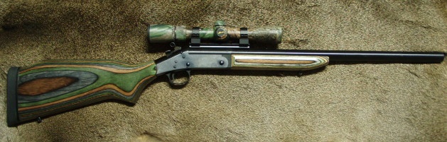

« Reply #15 on: August 29, 2007, 01:44:51 PM »
I have to apologise for the delay in responding as I said I would.... I plum forgot!!
 Here is a run down of all the WEAVER STYLE bases for the H&R NEF firearms and muzzle loaders...
Greg and Nomo, I think this is what your looking for, Its a WEAVER one piece base #60A and is shown to be available from Midway, Natchez and Mid-south. Its listed as being made to fit the H&R 158. Fits current barrels with radius adjustment, holes same.
As most know the WEAVER #82 base is STD for the H&R/NEF rifles.(But a tad long with rear slot too far forward and too far apart for most scopes)
 Leupold is offering one in its "RIFLEMAN" line and its listed as fitting the HUNTSMAN and SIDEKICK Muzzle loaders. (They are drilled and tapped the same as all NEF/H&R barrels)
H&R/NEF factory offers two different bases, one reg and one ULTRA. Basically the ULTRA is bit longer and has a front "support" screw. Both offer multiple slots for different scope fitment. Either would be my first choice until someone makes a STEEL BASE that is.
I hope this is what you guys where looking for..
 CW

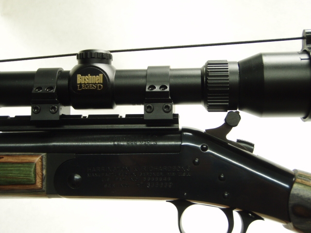

I just recently added the Durasight rings to two of my barrels. They fit perfect I did not need any hammer clearance and they also fit my 44mm scope.
CVA Durasight™ Z2 Alloy Scope Base and Medium Ring Set are the ones I used. It came with a base but I did not need it.
http://www.cabelas.com/spod-1/0041180.shtml
I bought mine at BPS.
Brian

Brian, what Durasight base did you use? They don't list one for Handis.  ???
http://durasight.com/z2_alloy/scope_bases.html
Offline Hofs01
  • Trade Count: (37)
  • Posts: 581
Re: ....the best rings for handi
« Reply #29 on: January 14, 2008, 05:51:21 AM »
Tim,
I just used the Nef scope base. They fit fine.
I can take a picture if you would like to see how it fits.
