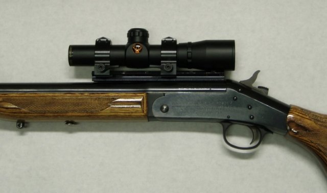

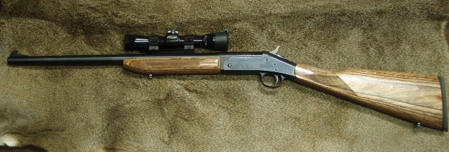

  • Posts: 43304
Re: Scout Scopes on a Handi Rifle
« Reply #10 on: January 23, 2007, 11:26:48 AM »
Mounting a long eye relief scope just ahead of the hammer isn't the same as a scout mount which puts the scope ocular bell near where barrel sights would be mounted, there are a bunch here that have shotgun scopes mounted just ahead of the hammer. The Ultra rail does make doing this easier tho. ;)
