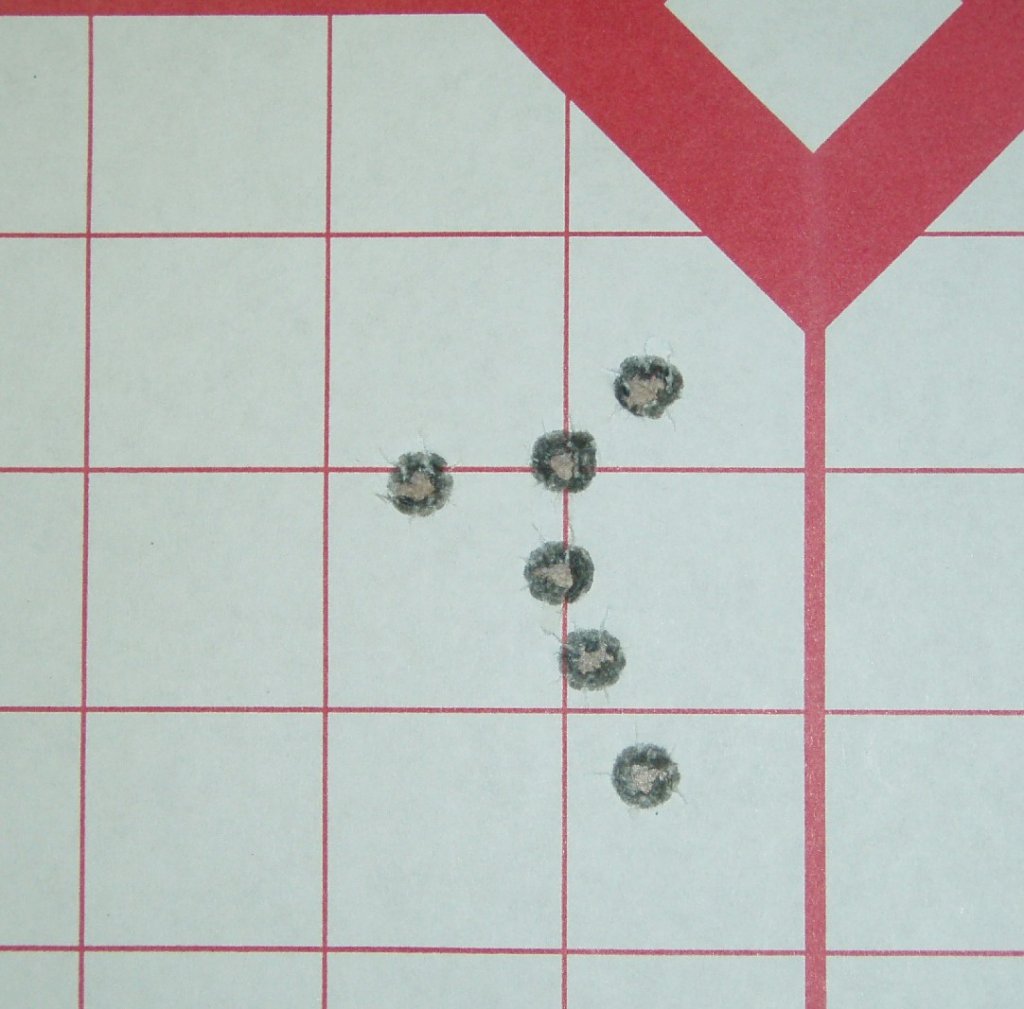

The 308 bull barrel made the trip today too, it  was digesting the 168gr TSX, very accurate it was with the right load, since it’s a bull barrel, I shot a 6 shot string just to see how heat affected it, I shot 2 loads in ½gr steps, 3 shots each, all back to back, the 42gr load of Varget was a diagonal string that measures .911”, each shot even spaced, the 42.5gr load was just above it, but one shot even with the first of that weight and one above and to the right slightly, that group measuring 1”.
https://www.gboreloaded.com/mhp/images/quickdtoo/308168grtsxg.jpg
