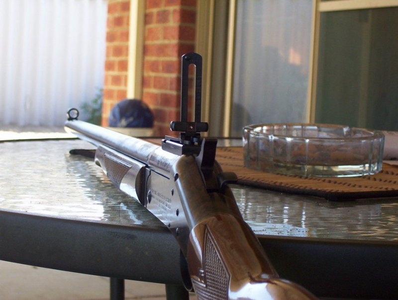

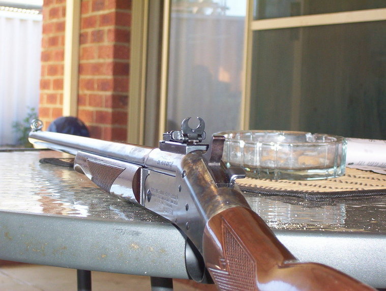

Today was the first day I shot the Smith Ladder with rear Buckhorn sight.  I really exceeded my expectations for a fixed sight.  Didn't get to shoot with the ladder as I was at a 100yd range and the Buckhorn was great.  Shot two different loads 1)  29grs of H4198 with 405gr Meister cast FN that average 1249fs with a spread of 17fps, the load is still just a little under for my purposes.  Will add two more grains and try to get it over 1300 to 1350fps.  Although it shot well and at 100 yds about a 2 to 2.5" group about two inches low. Shot 10rds with it and went to the bigger load.  2) 48.8grs of IMR with 405gr Remington JFN @ 1780fps with a spread of 14fps (boy they will wake you up).  Very accurate round but a guy wouldn't want to shoot more than 10rds of this before he went home.   Last four rounds were a 1"0" group at 100yds  with the Buckhorn  sight so I was well pleased with the product.  The  sight was great.  Am going to Hutchinson, Ks in next couple of weeks with some different loads to try my luck with the ladder at the 600yds ranges they have.   This is a lot of fun.

I really like the ashtray.  Those are getting rare.  :)
I will show my 1871 Buffalo Classic next week.  I sent it to Robar for a new finish.  Levergun made a awesome stock cover.  Simple, practical, and robust.  MV out!
