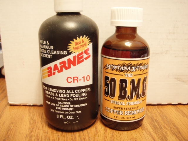

If you want the strongest possible bore cleaner for use with a NYLON brush, Montana Extreme 50BMG is the go to product, the other solvents like Sweets and CR-10 are mild in comparison in my opinion from my use at the range cleaning between shots at break in, and if you go by the ammonia odor, they're lightweights, the 50BMG odor will wake the dead :o and has a warning on the bottle top that should be heeded. ;)

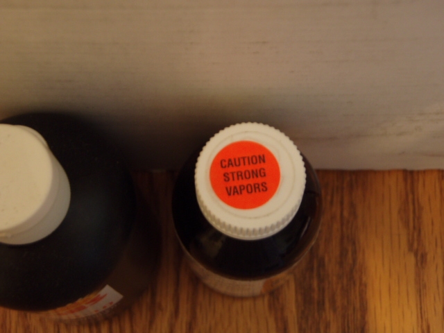

Tim, On the ammonia based ones especially the montana  Xtreme there is no doubt how strong they are, but isn't it true that you need to remove that as soon as possible from the bore as it will etch the bore if left in to long? Seems like I read that some where.   Jack

« Reply #13 on: July 31, 2007, 09:38:32 AM »
Yes, they're only for short time use, 50BMG says 5-10 minutes, CR-10 says no more than 15 minutes. Another one that doesn't have ammonia in it is Boretech Eliminator, it also works very well if you don't like ammonia products.
