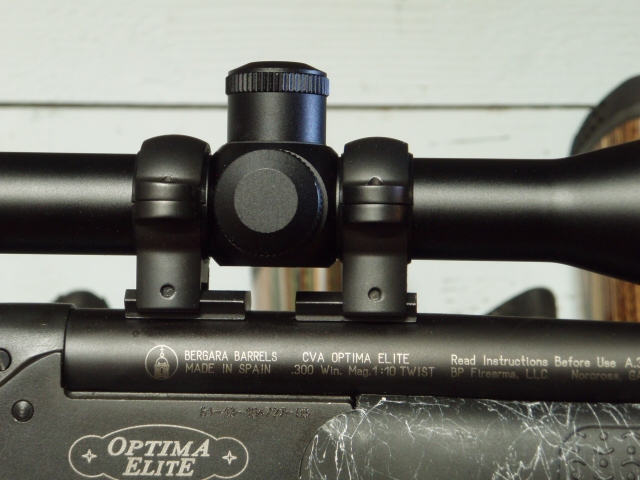

Sportsman's Warehouse doesn't carry anything for CVAs even tho they sell the Wolf and Optima!! The Warne 9.3 Maxima M980 bases also fit the Winchester X150 and Apex as well as all round barreled CVAs and Traditions, you'd think they would carry them but don't ,had to order the Warne bases from Brownell's, they fit fine, but don't give any allowance for positioning the scope as the one-piece base does, but no one has the one piece steel Durasight base, so these will have to do. Fortunately, the Mueller 3-10x44 TacII has perfect eye relief for me mounted in medium Burris Signature Zees, when I mount the rifle, I have to creep just a tad forward to get a full field of view, which is better than getting scoped by the 300 Win Mag recoil!! :o Range trip next Wednesday I think, have a batch of Nosler 150gr partition molys loaded up with H1000 to test it out with, that's Nosler's recommended accuracy load with a load density up to 103%, thought I'd give it a try..... to start out with any way. :D
Tim, is this going to be a rifle test or a scope endurance test.          Your scope is going to be like a tuning fork. To have a stable, strong scope mounting platform, your rings need to have the maximum spread you can utilize. This takes the maximum stress off of the scope. If you use the Caldwell DRT rest, the stress will be magnified, as the rifle will have less movement & the shock loading at the rings will be dramatically increased.
Your potential for accuracy is not as great this way, I would rethink this set up, doesn't cost hardly anything when compared with the overall setup anyway.
  • Posts: 43304
Re: 300 Win Mag Barrel!!
« Reply #18 on: August 16, 2007, 02:35:02 PM »
Yeah, I've been thinking the same thing, just not in the same terms, but I just don't feel real comfortable with the rings that close on that size scope. Although I'd like the steel Warne bases, the Durasight still looks like a better option, I ordered one earlier this afternoon!! ;D
