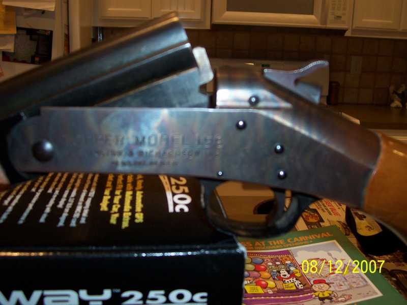

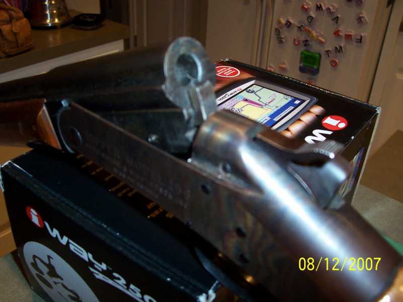

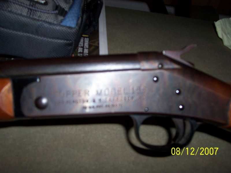

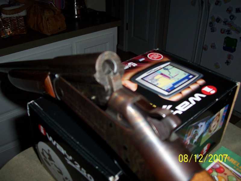

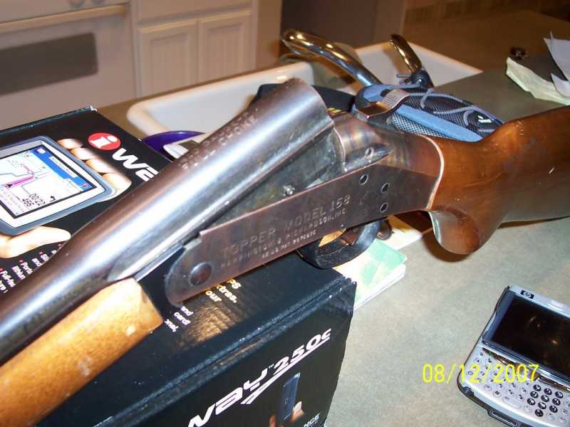

Hey guys,
Here is some pics of my pride and Joy. This is the gun that started it all for me. My dad gave this to me in 1978 (i think). He told me that we could eventually find a 30/30 barrel for it. Last year (28 years later) I finally hooked up a MATCHING 30/30 barrel that was made for this gun. It is almost impossible to find barrels that match the barrel profile. I have found 2 .410's, 1 30/30, and a 20 Gauge. I bought them all. These special barrels are snap on forends only. As I said before I would like to have the Jet and Hornet barrels to match as well. With luck I will find them one day.
