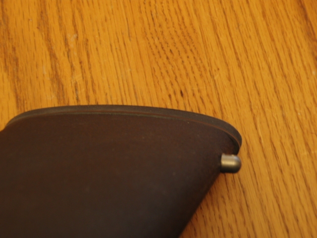

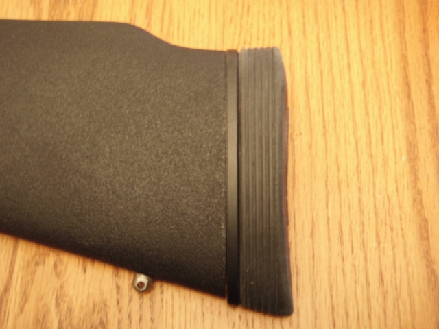

A fella at Shooters Forum asked about an upgraded recoil pad for the H&R synthetic stock, and I got one of those bright ideas that happens once in a while. ::)  I have a Tikka T3 Lite 338Winmag with the Limbsaver #10011 pad on it, I compared the OEM pad to the contour of the synthetic stock, it's real close, so just for S&G, I removed the Limbsaver from the Tikka and checked the fit on a synthetic stock, it's not perfect, but it's good enough to use, it's just a tad wider and taller than the stock, but I think it could be sanded down enough to match perfect or just used as is, it isn't off that much. The top hole in the pad mounting plate would need to be slotted just a little higher, and a new mounting fixture(block of wood) epoxied in for the bottom mount, unless the hole could be relocated slightly towards the bottom. I'd use it myself if I liked the synthetic stocks more, but I'm sure others here will be interested, specially those with 45-70s and anyone with a bad shoulder or shooters that are recoil sensitive. ;)
EDIT:  The #10018 prefit is made for the (old style Monte Carlo) synthetic Handi stock, also fits early checkered synthetic monte carlo, but not the late checkered syn monte stock that has the molding line behind the checkering.
Update 9/3/22: Limbsaver #10011 fits the early checkered syn stock after relocating the lower screw hole in the pad.

It fits flush with the end of the stock, doesn't have an inset portion like the factory pad. Basically fits the same on the Tikka stock, its factory pad has a similar inset portion on the pad like the H&R factory pad.

  • Posts: 43304
