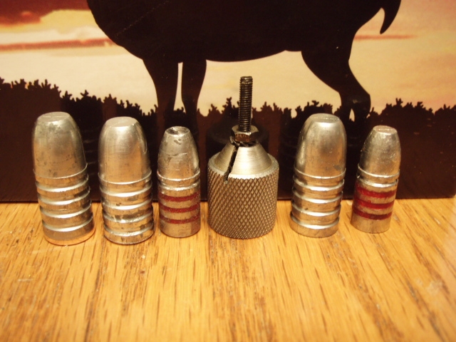

Bernie (dodd3) presented the idea of using the Lee deburring/chamfering tool to create a bevel base on plain base bullets to install gas checks,  here's a way to expedite the process since the Lee tool is hand operated which makes the chore very tedious. Grind the end of the tool flat and back just far enough that the resulting hole is big enough to insert a flat head 6-32 machine screw, then secure it in place with a lock washer and nut. Chuck it in a drill, put a leather glove on to hold the bullet securely, push the bullet into the tool base first while the drill is running slowly and cut a bevel sufficient to accept  and press a gas check on in a Lubrisizer, doesn't take much, 5-10 seconds will do it.
The bullets to the right of the tool are .460" and .379" plain based bullets, those just to the left of the tool are the same bullets with a bevel cut, and the far left bullet has been fitted with a .45 gas check, don't have any .375" gas checks yet, they're on the way with the 312gr .379"  Postell PB bullets for the 38-55.  ;D

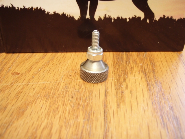

Modified chamfer tool w/8-32 machine screw and nylok nut instead of lockwasher

I like the idea , going to have to try it on some .458s for my 45/70s to add a little more speed , if i try pushing the plain base bullets too fast i get tons of leading .  ::)

Tim that's is a good idea but you could go one step more and use the gas check with a hole in the middle half up the bullet as well so you have two copper driving bands you could drive
them at nearly the same velocity as a jacketed bullet with a good lube.see pics no hole in gas checks but it gives an idea.ps i like the your idea with the lee tool.

I modified the chamfer tool to make it easier to do shorter bullets, an 8-32 machine screw head will allow .375" and bigger bullets to be chamfered before the screw head interferes, but I think a 6-32 would work for .30 cal bullets.
