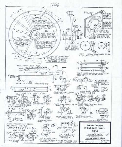

So Many of the gun build posted here are based on some sort of Naval carriage.  Some nice variations exist on this design and it is a simple cariage to make.  There seems to be a lack of field carriages.  I thing one of the roadblocks to making the type carriage is wheels.
I was going through my plans and noticed William Green's instructions and thought posting migh help some make wheels of there own.  This type post always seems to bring other "here's how I do it" reponses.  So here is William Green's method.
Click on link below the picture for lorger and clear picture.
http://www.fototime.com/3DCF86E61FCA6FA/orig.jpg
]http://www.fototime.com/7622B2036EC856C/orig.jpg
http://www.fototime.com/62646FDBA59FDCB/orig.jpg

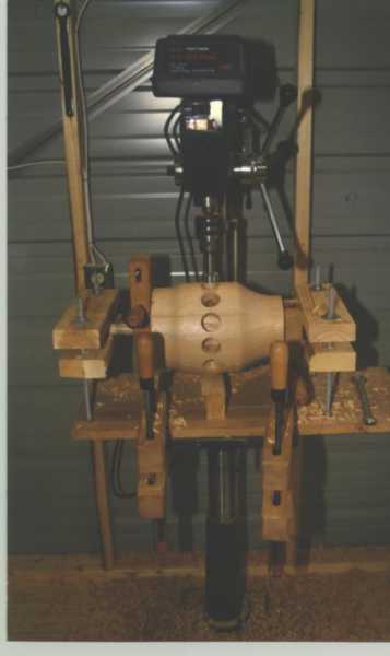

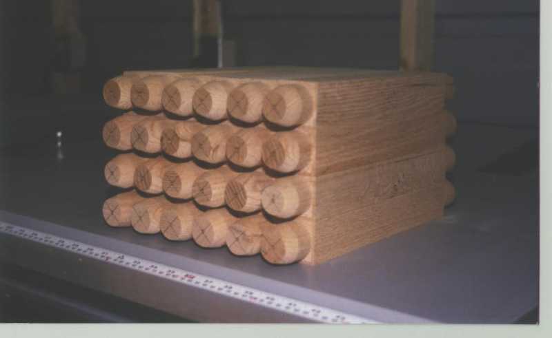

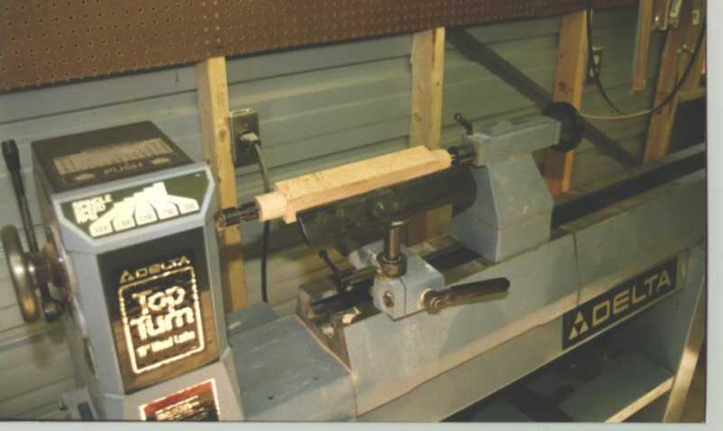

Here are the ones I made and forgot to post in the first post..  Politically correct and accurate they are not. Functional they are.
I confess I had help with this project.  But it was done on a bandsaw and drill press.  Hubs were made on the metal lathe from laminated blocks.
A square U shaped box jig was made. The angles were calculated and holes were drill so a dowel went across the two box sides at an angle   The dowel went through the hub axle hole and the hub sat an angle  A strip of paper was wrapped around each hub and a razor knife cut the paper at the over lap.  Paper was then laid out, measured and  and divide by spoke count and marked.  The strip was then taped back on the marks were punched into the wood. When a hole was drilled in the hubs at each mark and  spoke was insert it was at th proper angle and separation.
The fello's were cut and clamped to together and fastened to a sheet of plywod and cut out on the band saw.  After cutting out, a strip of paper was used on the inside and cut and marked similar to the hub. The fello's were  put in a angle vice and drilled on the inner side.
They were then glued and clamped.
I took the finished wooden weels to a local steel fabricator and the did the tires.
And that is the best I can remember something I did 24 years ago.

It appears that this wheel was made with 8 felloes and 14 spokes, which seems to be an odd way to make a wooden wheel.  It causes the spokes to go in irregular places in the felloes (sometimes right next to the joints) instead of the same, symmetrically oriented places if there were a 2 to 1 ratio between spokes and felloes.
  • Posts: 12610
Re: Are you intimidated?
« Reply #10 on: November 03, 2009, 01:26:05 PM »
Don't ask me, I was just the unskilled labor and direction follower...besides it was 25 years ago..  We made 6 of these wheels or was it 4....
« Reply #11 on: November 04, 2009, 08:57:28 AM »
This was discussed on an earlier thread, but I couldn't find it; W. F. Green offered alternate methods of building field carriage wheels. For the model maker that wanted/needed an easier way, W. Green added one more felloe, and drew his plans using dowels for spokes instead of authentically shaped scale spokes.
Enlarge, and read instructions for making wheels.

The issue of angle of the tyres is address in the Wheel construction sheets.  If you look very closely at the sheets you can see it.

No, the drawings aren't contradictions. The drawings each show a method to make wheels.  The drawings each will make a wheel for their intended purpose.  But they don't all make authentic copies of original wheels.
