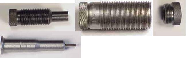

The LEE .357Mag Speed Die loads my .357MAX just fine. For those that aren't familiar with the LEE Speed Die, it's a 1 piece die that you have to change out componenets in the processes of sizing, belling and bullet loading & crimping. The picture shows the 4 basic parts minus the locking ring. The one thing I don't like, due to the extra length of the .357 Max., is accessing the carbide insert, after the die is set for the cartridge, as it is up inside the press to where my stubby arthritic fingers have trouble and the depriming pin is too short for the .357 Max. That really isn't an issue since I use a LEE universal deprimer anyway. It would just be more convenient to have seperate dies set up.
