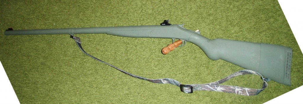

I decided I wanted to kill a turkey with this old gun, I hunted with it when I was a kid, killed lots of grouse, pheasant and a few ducks with it, and my Dad killed a tom with it in 1996, we called it in close and he shot it with regular high base 2¾ #6 loads, he wouldn't shoot magnums in it!  :D It has a full choke which Federal recommends for their Flitecontrol ammo, so I decided to try it, but after getting the gun back from my uncle who acquired it after Dad died, I found it full of about 100yrs of dirt,  so I disassembled it to clean it, the steel  trigger guard has only one pin in it that is also the trigger hinge, no lower front pin as on newer H&Rs. The large coil spring is the main spring or hammer spring and is a bear to remove if done incorrectly (which I learned after the fact!! ::)), if you cock the hammer, you should find a hole in the the rear of the main spring guide(part 56 on the 1900 parts diagram), the hole on mine was full of dirt just like the rest of the action and why I decided to cleqn it in the first place before I shoot it, so I didn't see it, should have figured the notch was for something tho, but hindsight is always more accurate than forethought!!  I put a yellow paper clip in the hole for clarification, you cock the hammer and hold the hammer all the way back, insert a pin in hole, then the hammer can be lowered and the spring is held in place preloaded and can be removed for disassembly. Pins are smooth, so they can be removed from either side.

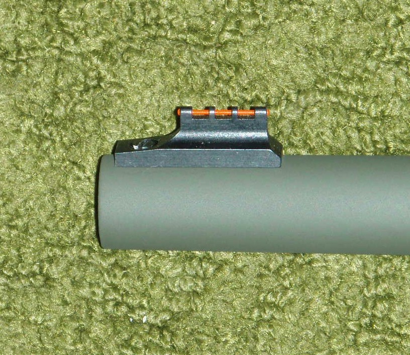

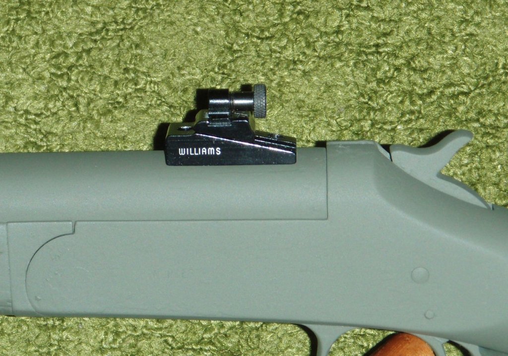

 ;D ;D Dad painted it and put a rear sight on it for turkey hunting, just a slotted screw in the firing pin retainer screw hole, but it worked. He also soldered a sling mount to the barrel which I'll be using. I've drilled the front bead mounting hole out to mount a Firesight on it, have the chamber drilled with a single blind hole to mount a Williams WGRS, I have an order in at MCK Tool for a 6-48 plug tap to tap both holes, then I'll mount both sights using Black Max 380 Loctite or epoxy and the single screws. It will be painted flat black when I get all done, I'll post a pic.

I got the barrel tapped and the front sight screw trimmed so it's flush with the bore, that was a real trial and error project!!  :-X The stock needs some repair, has several cracks in the wrist area that needed glue, fixed that yesterday, will do some sanding next and then paint it, should be ready for pics and shooting in a day or two.  ;)

All done, just need to pattern it! While looking at paint, the Krylon Fusion Ultra-flat camo colors caught my eye, so I decided on olive instead of black.

very nice , the sights look perfect for a turkey gun .the paint job is nicely done as well . have you tried to do camo with some of the foliage from were you hunt ? that can turn out very well , i have done it before on synthetic stocked guns as i don't much care for all black guns .

Very nice Tim your dad would have loved it!

Thanks guys, I thought about adding some more camo colors, but for now I just want to make sure it shoots good first, may "customize" it later. The pad is an Uncle Mike's that I bought years ago, it already had some camo paint on it, wasn't showing signs of chipping or peeling and it fit good. ;)
