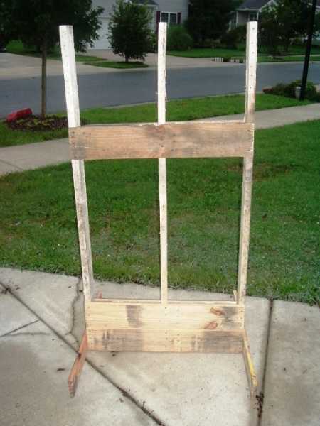

The first thing I need to do is Pattern all the Guns. I looking at 20 yards being the maximun range for harvesting the bunnies. Hunting bunnies behind beagles usually means shots from....at your feet to 30 or so yards. We hunt in the thick stuff. I will start the patterning at about 10 yards and probabily just shoot one pattern at this distance, not sure how tight it will be. Then continue to 15, then 20 and end at 25 yards. at the 20 and 25 yards, I plan on shooting 3 to 5 patterns. The goal is a good pattern in a 20" circle at 20 yards.
The loads are Winchester 2.5" number 8 shot Double AA HS Sporting Clay loads. The FPS is 1300 which is marked on the box. I will Chrongraph acouple becuase I am reloading them. I think the 8's will do the job because of the range limitation I have placed on the group of users.
Tomorrow we are going to the State Fair and hopefully I will be able to start patterning Tuesday afterwork.
The  patterning board is made out of a Ol' pallet from work!
Rolls of old blueprints that will be taped together for the patterning paper!
Until the middle of the week,  BE SAFE!
Froghunter

How many pellets will reach the neighbors window across the street :D ;)

« Reply #8 on: July 27, 2010, 04:33:29 AM »
   I was thinking the same thing. If i tried that where i live i would end up in Jail. :o
