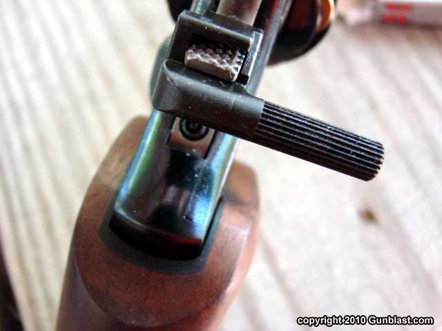

Anyone think this one could be modified for Handi use?  Update 17 OCT 2010: The answer is no, unless you heavily modify/grind the extension to provide clearance for the Handi hammer.
I found it here. http://www.gunblast.com/Taurus-CircuitJudge.htm

The only way to know is order one and try it, I looked for cheap shipping sources, didn't find one, everyone wants $8 or more to ship a $5-$6 item or $4 shipping for a $10 item, Rossi may be the best source.

 Dinny with that one on the back of the hammer, wouldn't it get to close to the release lever?
Lonny
That is certainly a possibility, it's a gamble. I have lost more money to things much more foolishly than this. ;) ;)

« Reply #27 on: October 07, 2010, 10:48:50 AM »
I already called them. Long wait ended with me leaving a message on their machine. :-\
Thanks, Dinny
I have one on the way, $11 something shipped. Will be here in 6-8 wks... >:(

Is there a problem with the Uncle Mike's spurs?
Offline Dinny
  • Trade Count: (268)
  • Posts: 5524
  • "Medics Save"
Re: Different hammer extension
« Reply #29 on: October 07, 2010, 11:16:46 AM »
Too short for my taste.
