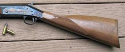

I recently threw in the towel on shooting my CR 45LC with the open sights after trying various "old guy eyes" tricks. 40 Yds. was the best I could deal with and I wanted at least 80 Yds. So, I mounted a Weaver 4x28 on it and started today getting her zeroed in. Bore sighted and then set up a target at 40 Yds., set the rifle in the old Lead Sled and 1st 3 were on the paper. Adjusted the scope a bit to change the POI and shot 3 more that followed the changes made. On the last shot, I noticed something fly past my head and looked down and saw a piece of the walnut stock had split off the top section.
A really dumb mistake on my part. All my other rifles that I've used in the Lead Sled have a pad of some sort on them and I forgot this Classic Carbine has none, only a steel plate. The Lead Sled has little or no padding on the back, thus each time I fired,it was like I was slamming the butt stock plate with a hammer and the top rear section of the stock took the brunt of each hit. Luckily, only a small piece split off, about 3/8" thick and 1-1/2" long.
Hopefully this error on my part will help someone else in the future avoid a damaged butt stock.

Re: CR 45-LC vs. Lead Sled
« Reply #4 on: November 11, 2010, 08:21:18 AM »
Thanks for the ideas on alternate methods of cushioning the butt stock Tim. I'll definately be making some modifications. I've got a few ideas to try out.
Dinny, I may have to try a recoil pad anyway. I need a bit more LOP to fit me to the Extended Eye Relief of the scope. A slip on Limbsaver may be on my wish list.

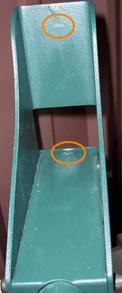

Looking at the shape of the butt stock I began to wonder why the top section was even being hit.
So taking a closer look under the padding I see why. The bottom was actually taking the first lick, then sliding over the small lipped edge before the top smacked into the the back of the sled.
There will be more cushion added in the future for sure.
TJ, a little Gorilla glue took care of the break. It was a nice clean break and of course I know where it was broken but it would be difficult for someone else to spot.
Bill
