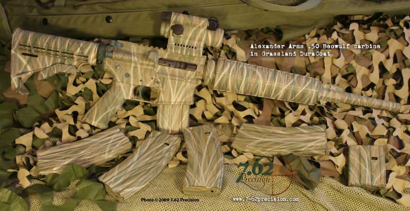

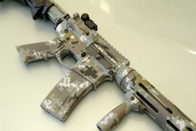

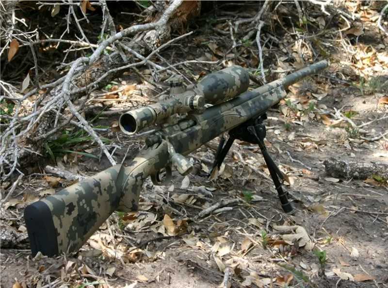

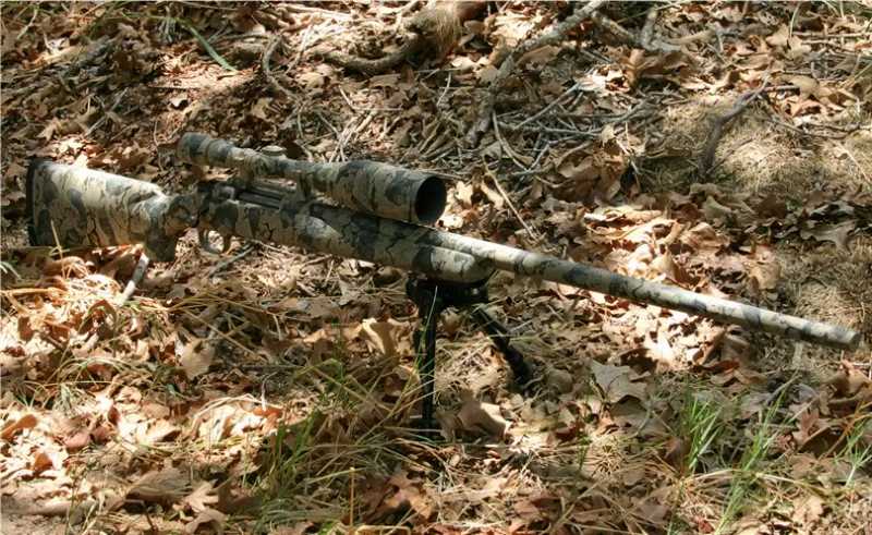

Duracoat it and never even think about rust again!

I have thought about painting it, but idk if I really want to or not,  but since it is a syntheci stock I'm debating it.
