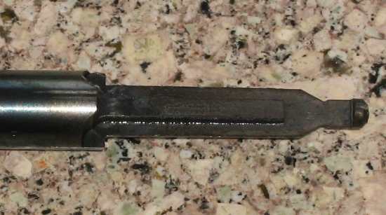

I just finished a "D" reamer to the drawings and have reamed a test chamber, just waiting on some loaded ammo to do a reality check before I ream the barrel for real.  Larry

Offline trotterlg
  • Trade Count: (36)
  • Posts: 3978
Re: Who is looking into the 17Hornady Hornet?
« Reply #19 on: February 22, 2012, 05:33:13 PM »
