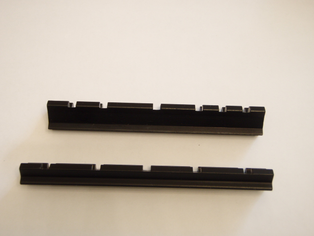

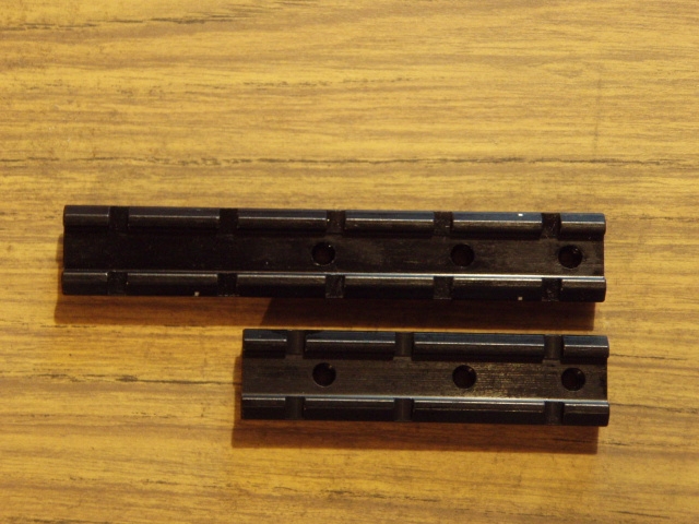

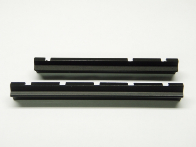

top to bottom: H&R Standard rail, H&R Ultra rail and Weaver #82
Leupold top, H&R standard bottom

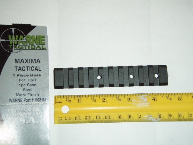

Steel Warne Maxima Tactical, comes with T15 Torx head mounting screws
Warne M681M STEEL Tactical Picatinny base
