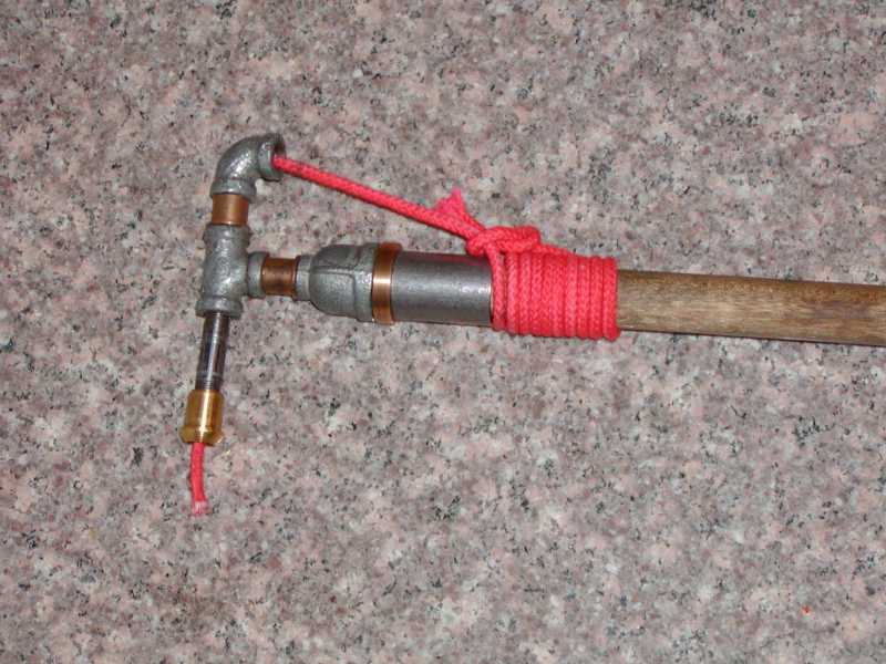

Try your local hardware store. Look for "Grant's Stump Remover". It is 100% KNO3. It goes for about $5 a pound.
Thre are other stump removal brands, but I think that only Grants is KNO3.
You could try a agricultural fertilizer distributor as well. You would be looking for "13-0-46 " . They might call it KNO3 as well. If you can get it there, a 50# bag should run you under $20. My local delaler (a big place) does not carry it any more, but I hear that some places do. My local dealer only sells 500# of anything minimum buy... sort of commercial sales only.
I have seen it on internet but shipping is a killer.
The $5 bottle of Grants will make a lot of slow match.
As a side note, I add food coloring to my mix. It colors the rope so you know it is slowmatch and also gives you a hint as to how uniform your job came out.... and it looks sooo pretty as well ;)
Make sure you don't have a nylon core in the cotton rope. If you can not get uncored rope, then cut cored rope into lengths and snake the nylon core out of it. It is not impossible to do as long as the lengths are under 5-6 feet. Check with Magician's supply http://rope.ws/ . They often have uncored cotton rope and their prices are great.
I have never tried it, but I heard that hemp rope is more traditional. Maybe I'll make up a batch of hemp rope sometimes soon and try it.

O.k I'm a little less Pissed now. thank you all! I'm getting some Grant's A.S.A.P. as I do not have all day to make it from dirt.  M223  P.S. Thanks for reminding me I need to pick up some food coloring too. you guys have some great posts on making slow matches Thanks again.

For slow match just buy some Grants Stump remover or use a little BP. Mix water and BP and pour through a few coffee filters. The charcoal and sulphur are trapped in the filters. Dump your cotton rope in the liquid, it contains the KNO3. A little bit goes a long way.

Well I went to Ace they did not have any Grants , but they had some 3/8 " natural sisal hemp rope. I got 10' for about $1.70. Then I headed over to Tractor Supply, They had Gordon's stump remover 1Lb. was about $4.80. The local fabric store was closed so I went to wall mart, in their sewing section I found  100% cotton rope in 1/4" and 1/2"  a $1.67 for 9' of the former &  $3.27 for 9' of the latter. I also got some red food coloring for $1.08. In a large glass bowl I mixed 1 1/2 tablespoons of Gordon's stump remover with 4 cups of hot water and red food coloring . Into that I placed the different ropes to soak for about 15 minutes. They seemed to soak this up well and are all very red as well are my hands. I took the ropes outside and laid them across the the hot hood of my old pickup in the sun. When they are dry I will post the results of this experiment.

You lucked out... Gordon's is KNO3 also http://www.pbigordon.com/pdfs/StumpRemover-MSDS.pdf Not all the stump removers are.

O.K. I found a post on linstock on page 30. Rickk writes,    " Bonide Stump-Out is sodium metabisulfide ....different stuff " So I owe Rickk another thanks Because that is what Ace had on there shelves.  Thank you both Rickk and Lesmoore , as well as everyone else who shares there time and information.   M223

Holy smokes, it works! Wow I made this batch up around 1:00 pm and it is already to use at 5:30 pm. It is about 90 degrees F. outside and probably hotter on the hood of my truck. Now my results. First off I have not tried the 1/2" cotton rope when it dried it was pretty apparent it needed to soak longer, as when I unwound some strands it looked just like a candy cane; However the sisal rope and 1/4" Cotton both work great. The 1/4" cotton seems the best although it burns twice as fast as the sisal. The cotton has a tighter weave and once lit forms a perfect red hot cone that needs no blowing on. It burns about 1" every 4 minutes. The sisal is 3/8" diameter and red all the way through. it is not as tightly woven as the cotton, once lit and going well it seems to do great also, not quite the perfect cone, and it smokes quite a bit. It seems to burn about half as fast as the cotton. Maybe 8 minutes per inch. Now I need to make a linstock, and to think all the fourth of July's I used a crumby punk. This is a fun project everyone should try. Thanks   M223
