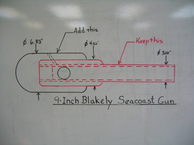

Re: What to do with this thing?
« Reply #8 on: January 06, 2008, 04:36:06 PM »
    Victor3,   Take a look and let us know if this might be a possibility.  The top image is from The Big Guns by Olmstead, Stark and Tucker.  It is a large, British Seacoast Gun of the type used in the 1860s through the 1880s in England and her throughout her Empire.  The sketch is drawn to a 1/4 scale and also allows the slap hammer to be retained with a very slight modification to the tip.  The extra weight would allow heavier projectiles to be shot without uncontrollable recoil consequences to prevail.  All thickness rules would be met without a finicky chamber insertion operation.  We have drilled several slant vents;  you could easily do this with your experience.  Tap and then screw in a stainless vent-piece, and your all set.  A metal carriage could be designed and built to duplicate those in use in the Palmerston forts or you could go all-out and put it on a Montcrief disappearing carriage such as the one which can be found at Crownhill Fort today.
Let us know, Victor3.
Good luck,
Mike and Tracy

Offline Victor3
  • Posts: 4241
« Reply #11 on: January 06, 2008, 07:14:17 PM »
Good luck,
Mike and Tracy
 Mike/Tracy,
 That's an excellent idea. I hadn't even thought of adding another chamber piece - I had only considered  a bbl insert to go to a smaller bore. I appreciate your taking the time to post the picture and making the sketch for me. I have not seen many cannons (only mortars) having the trunnions back that far. I like the looks of it a lot.
 I have everything available to modify the bbl just as you show, and will certainly consider it when I can find the time to get this project going again.
 However, since I still have a 40" long piece of the 2.25" ID tube, I may just make up a Blakely breech for a new bbl. That might end up being easier than modifying my existing one. The breech would be a fairly simple item to make and heat-shrink onto my tube.
 Do you by chance have any pics of the "Palmerston fort" mounts?
 Thanks a lot guys. Certainly some food for thought for both my existing gun, and maybe a new one also!
 Regards,
 Victor
« Reply #14 on: January 07, 2008, 10:50:59 AM »
     Victor3,   Mike and I agree with you, it's probably best to leave your unique cannon as is or maybe make just a minor change.  It's important, we believe, to have some "history" of what you have built.  Terry C. just posted the first entry in a new thread called, "the Official 'ones we don't talk about' thread....., which is an idea with lots of potential.  So, if you decide to craft a big British gun, fine; do it from scratch.  That method would probably yield more satisfactory results.  All the artillery drawings and photos you will ever need on the subject of British seacoast guns can be found at the link below posted by MikeR C just recently.
http://www.palmerstonforts.org.uk/index.php
Regards,
Tracy and Mike

 Great post Dom. I think I understand where you're coming from with your formula.
 I'm familiar with Barlow's formula for determining bursting pressure of tubes. I've used it in designing pressure vessels. The basic formula is:
 P = 2 St / D
 Where:
 P = Bursting pressure (psi)
 S = Tensile strength of tube material
 t = Wall thickness
 D = Outside diameter of tube
 The formula can also be rearranged to determine what is needed in terms of tensile strength or dimensions required for a given bursting pressure. Here's a useful link:
http://www.dixiepipe.com/barlows.html
 I believe that this formula must have been what was used by the early cannon designers along with other considerations.
 You appear to have distilled what was learned by our cannon-building forefathers down to a simple, safe, and useful formula. However, there are variables that if they were to be defined and considered, would make it more precise (But also more complex, and maybe less useful to some).
 In regards to "double sleeve" cannons, this might be an interesting read:
http://en.wikipedia.org/wiki/Hoop_stress
 Using Barlow's formula to determine bursting pressure on my bbl, it would contain ~40K psi at the breech.
 Dom, I'm very comfortable with the loading of a pool ball and 200 grains FG, but I will certainly take your advice and start out at 100 grains to see what it will do. You're right - no use in wasting powder.

                                                           Doug, I'm not sure if Collado or Muller had a written table or formula for determining maximum weight of a projectile.  I think the projectile itself determined the weight of the tube and the charge. That's why I used the phrase "general principle".  I do know that the weight of the projectile was a factor.  Both of these individuals wrote about it when explaining construction and use of artillery tubes.  I'm not saying that a formula does not exist.  I simply don't know if one does or not.  The closest I can find to it, is from Muller, who designed for example, the heavy garrison guns to have 172 lbs for every pound of shot, and ship guns weighed 146 lbs per pound of shot.  Also, there was a table for barrel thickness along the length of the tube measured at the vent, trunion and chase.   Length of barrels were 15 calibers for the ship guns and 18 caliber for the garrison guns.  He kept the powder charges at about one third of the weight of the projectile.  Collado varied the powder charges.  Full weight of the ball in powder for the double culverins, four-fifths for the legitimate and two-thirds for the bastard culverin.  It appears that everything was determined using weight as their unit of measure back then, hence the word "pounder" , 6 pounder, 12 pounder, 24 pounder etc.
                                                           What I am saying is we are fairly certain from experience that a "properly constructed" one caliber thick cannon of the correct material can fire a lead projectile using  the Switlik chart, safely.  Then, by using the table of weights for lead projectiles at a given diameter, we can determine a safe maximum projectile weight for a cannon that is less than one caliber thick by using the thickness of the breech as the bore size.  With presenting this method, I am not advocating for the constructiion of  lightweight cannon and I also think that the one caliber thick rule for the Forum is a good rule and should certainly not be changed.   What I am proposing is, since there are so many cannon in use today as in the past, that are less than one caliber thick, here is a method of determining how to use them safely.   Dom

Let me add the standard warning, the formula's are just a STARTING point.
The nature of the dynamic pressures of a cannon is different than that of hydraulics.
One MUST account for the repeated hammerings that a tube will encounter - that's not in the formula - it involves both good design and good choices of the type/nature of the materials involved.
If you're not a mechanical engineer or a metalurgical engineer you run the risk of missing that critical element that could get you killed.
Comparing your designs to those that have been proven over time with many applications by many people is simply prudent.

 I agree completely, CW.
 I only posted Barlow's formula because it is similar to Dom's formula in that there is a relationship between wall thickness and a safe pressure/load that can be calculated. I didn't mean to imply that Barlow's (or any other single) formula is the only thing to be considered in a cannon barrel's design.
 I like Dom's formula in that it has a hefty built-in safety factor that limits projectile/charge weight for a given breech thickness (assuming a normally designed bbl).
 As Dom noted, there are many 'under-built' cannons out there that will be fired - Just like there are many Trapdoor Springfields that are used daily. One wouldn't want to use a full-zoot load in either gun, but they can both be fired safely if a safe load is able to be determined.
