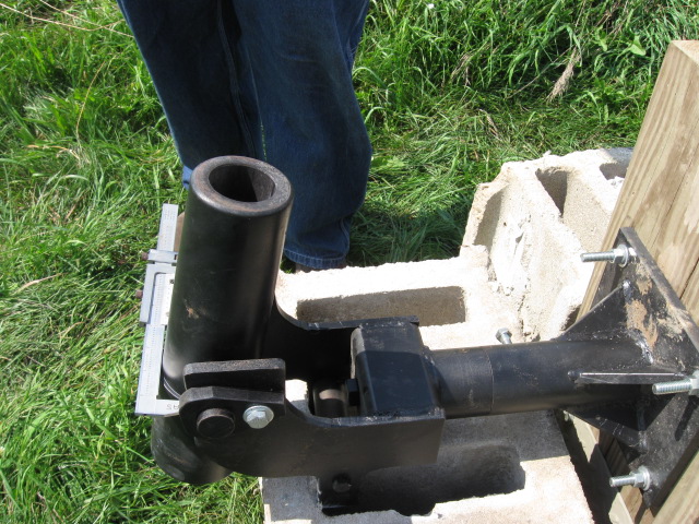

Bore is 1" wall is 1.125 . I will mic the OD after each shot . Armorer77

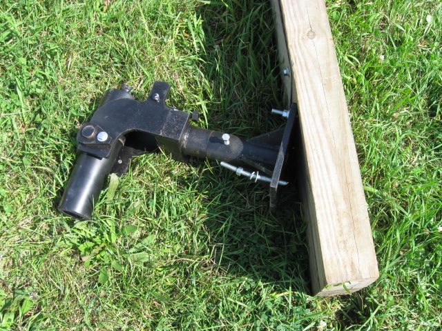

Testing is finished for today . I reached 1000grs. with 4 1lb. lead balls before destroying my testing base . Pulled the heads off 2  3/8" carriage bolts putting an end to todays shooting . For the curious , measuring just ahead of the chamber reinforcement band . No noticible change . Total varience was +.0006 " Photos and movies to follow This evening . Armorer77

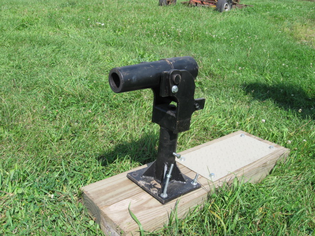

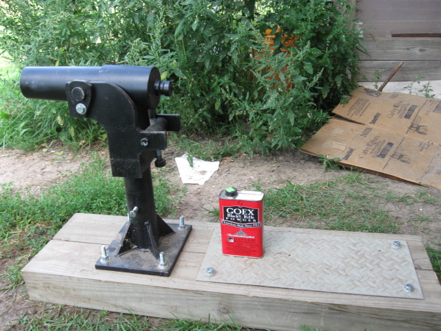

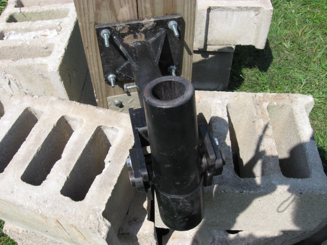

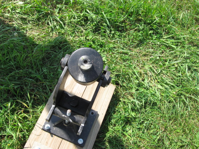

Here are the pics from todays shoot .
The victim
The Perp
3rd shot : 500 grs. 4F w/ 2 1lb. balls
4th shot 700 grs 4F w/ 2 1 lb balls

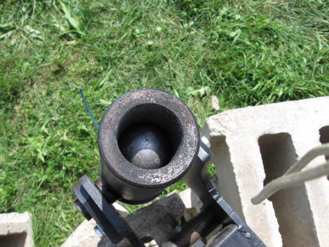

The final shot of the day 1000 grs. 4F w/ 4 1 lb. balls
The results

 You say up above that the cannon has a 1" chamber. I'm wondering how much powder it holds. I assume that on your heavier loads, some of it must have been overflowing into the larger diameter bore?
 On your final shot, about how far did the 4 balls go?
 In measuring the OD for change, were you using the vernier calipers shown below ???
