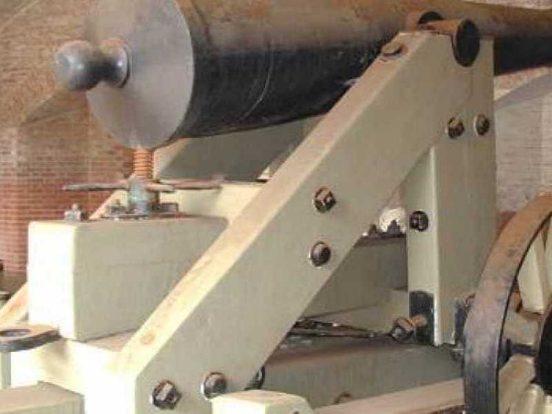

Can someone explain how the leveling screw in this drawing works?  When you turn the handle the threaded rod must go up and down.  Is the handle fixed and goes up and down also?  I guess that can't be the case because it couldn't go down any further.
I have seen pictures of the handle in a fixed position on the top of the threaded rod.  Then it is obvious how it works but I'm confused with this drawing.

« Reply #6 on: February 14, 2010, 05:59:20 AM »
Some artillery adjusting  mechanisms have the hand wheel fixed to the carriage and it does not move up or down, just the screw moves when the wheel is turned, one end of the screw being fixed to the barrel. Some large water valves also work this way, I think they are called traveling screws or something like that.
Max
Re: Barbette Cariage
« Reply #7 on: February 14, 2010, 06:17:52 AM »
     The other type is shown in the Civil War era photo.  The handle is affixed to the elevating screw with a cross-pin at the top of the screw and the elevating screw plate is threaded to hold the screw in any position of tube elevation or depression.  Without tube preponderance, extra weight aft of the trunnions, neither type of elevating screw would work very well.
T&M
« Reply #8 on: February 14, 2010, 06:38:41 AM »
Max Caliber,
For that to work the hand wheel would have to free turn in some type of housing that would be attached to the carriage.  Is that what you mean?  Do you think that is the case in the drawing?
Offline Terry C.
  • Posts: 1215
  • I see what you did there...
« Reply #9 on: February 14, 2010, 09:38:40 AM »
The elevator in the photo, with its hand wheel affixed to the screw, is probably a simplification of the original design, for ease of manufacture. In this case it would simply screw, as a unit, into a threaded socket in the transom.
The screw in the photo is free to raise and lower in it's socket, but not rotate. It would have either a slot in the screw for a pin to ride in, or a pin in the screw that fit in a corresponding slot in the carrige. Either way, rotating the threaded hand wheel would raise or lower the screw and set the elevation. The bottom of the hand wheel bears against the top of the unthreaded socket.
To me this is a superior design, as the hand wheel is always down out of harm's way. It would also be stronger and operate more smoothly, but it is more complex to make.

« Reply #10 on: February 15, 2010, 01:53:45 AM »
Zulu, The hand wheel is held within a metal box like affair on the trail, free to turn and move a little from side to side. Here is a picture of a British gun carriage that uses a captive hand wheel but has an elevating screw that attaches to the barrel with a bolt. This type of mechanism was apparently used mostly on light and medium size artillery.

« Reply #11 on: February 17, 2010, 09:09:22 AM »
I think that we borrowed this concept of elevation screw from our British cousins, (though they may have also done the same from another country) but we didn't attach the top of the screw to lugs on the underside of the barrel. As has already been said, it's the preponderance (greater weight at the breech) of the tube that allows this design to function. The threaded collar with handles remains seated on the base plate when rotated, and the male threaded screw raises and lowers without rotating. I would also venture a guess that the threads of the screw, the bottom of the collar, and the top of the plate were all kept well lubricated.
Drawing of a British elevation screw for a field carriage.
Elevation screw seen on a reproduction British block trail carriage on which an original British bronze light six-pounder is mounted.
U.S. wooden front pintle barbette carriage with the type of elevating screw where the female threaded collar remains seated on the base plate.
« Reply #14 on: February 17, 2010, 10:36:00 AM »
Okay, DD's drawing shows the groove in the screw that I mentioned earlier.
Can't tell from the photo of the barbette carriage that Boom J posted whether that screw is slotted. If it is, the slot is turned away from the camera or otherwise hidden from view.
The other option that I mentioned is probably more likely. There could be a slot in the block underneath the handwheel for a crosspin in the lower end of the screw.
[edited to add: For a model, this would probably be the easiest method.)
Either way, the screw is held against rotation.
In the illustrated field carriage elevator, none of this is necessary because the upper end of the screw is affixed to the breech of the gun.

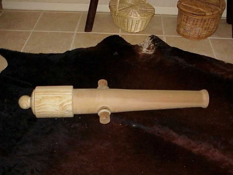

« Reply #26 on: February 23, 2010, 06:22:12 AM »
Well, here it is.  This was one of the most challenging carriages I have yet done.  It took a lot of study to just figure out how it went together.  It is a 1/3 scale 100 pounder Parrott rifle on a Barbette carriage.  My thanks to all who helped me out with answers to my questions.  It now resides in my foyer but there is no room to open the front door. ???  I will have to figure something else out.  The wheels are operable as is the threaded wood leveling screw.
Enjoy the pictures.
« Reply #27 on: February 23, 2010, 06:27:40 AM »
more
« Reply #29 on: February 23, 2010, 06:31:26 AM »
more
