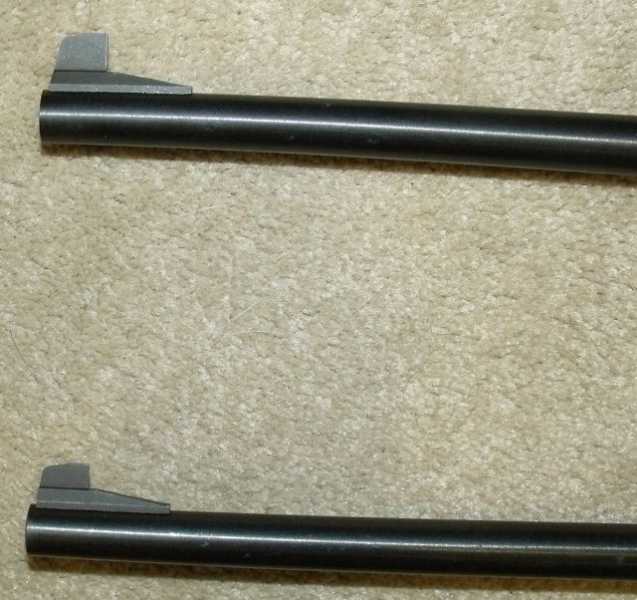

Here's a couple of pics of two of my VPs on C/F frames. You will notice in the lower pic that they have different height front sights. Anybody else have this?

Mine have the high one, the one on the top. How do they shoot with the front sight's they have? Especially the lower front sight?....<><....:)
P.S. - nice pair!!!
P.P.S. - I just saw your other post re: shooting the VP's at the range. Since the one with the lower front sight shoots high I suggest putting the high front sight blade on the one with the iron sights, that should bring the POI down. It looks as if someone may have put the wrong front sight blade on the open sighted one at some time. Perhaps a .22 Hornet front sight blade from the looks of it...and buy the way, nice looking old style stocks as well!!!

I did shoot the VP with the higher front sight when I first got it, and it was fine. The one with the low front sight I just tried as-is and got the high POI. It is going to get a scope as well, so it's not a big deal. Nonetheless, I think I will put the higher sight on and try it anyway.
