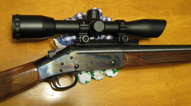

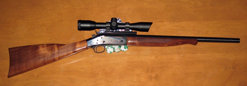

Well, I must say that my first barrel swap experience has worked quite well.  ;)  The new .223 barrel fit my .45-70 Buffalo Classic frame perfectly.  Slight wrist flick and she closes and locks up tight.  The new scope arrived today, but unfortunately, it was after dark, so I couldn't test today.  8(  I did get it bore sighted, so hopefully tomorrow afternoon or Friday evening might get some time to test.  I'm pretty happy thus far with the scope, but we'll see how it holds and zeros.  Anyway, my dies arrived also, so will be starting download development on Friday/Saturday depending on weather.  ;)  Thanks for lookin', hopefully will have some good reports soon.  ;)

I was going to recommend some light loads for squirrel hunting. After seeing that last pic, I say go with a 55gr V-Max at about 3300fps. ::)  That should do the job. ;)
I do like how your rifle looks. That's some real pretty wood.

Thanks Dinny, think I got really lucky on good wood on both my Classics.  ;)  The .45LC has good figure and is darker.  Like em both though.  ;)  I could never shoot my little guy.  He's been a lap fixture for me for many years.  ;)  Unlike most Chihuaua's, he only speaks when someone is at the door, you play bark at him or he gets frivilous with the cat.  Otherwise he's silent and one reason we've gotten along all these years.  He has lost all his teeth now, but still does pretty good.  ;)

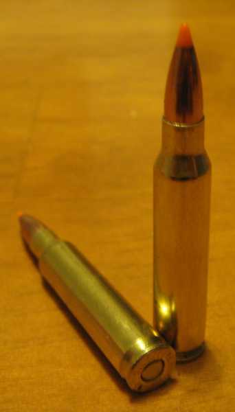

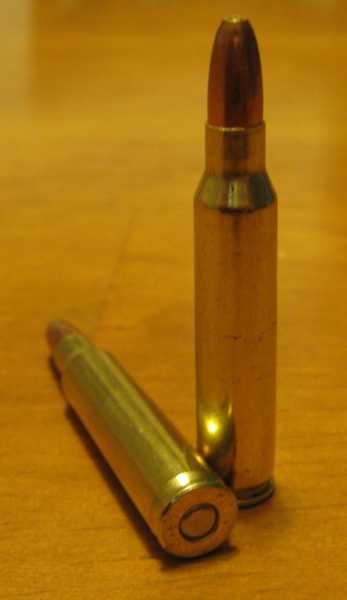

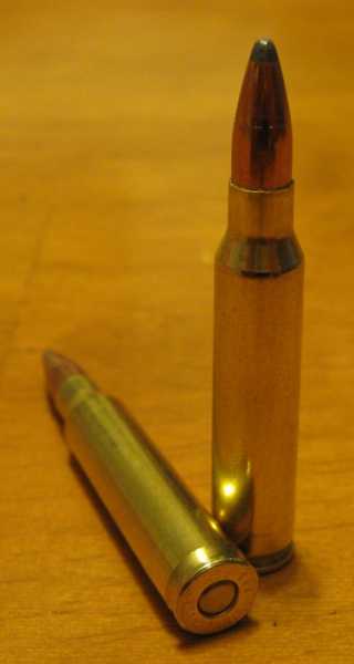

Well, I had a few hours today after takin half the roof off my dads house to load up a couple ladders.  I settled on testing the Winchester 46 gr. Hollow point for low velocity squirrel loads, because they are fast expanding even at the lower speeds.  These are loaded with 4, 5 and 6 grains of Unique to hopefully get down into that low 1k range.  ;)
I also loaded the same ladder with the Hornady 55 gr. SP bullets
and Finally, I wanted to try some Reloader 7 for some full velocity loads in a 17, 18, 19 and 20gr ladder.  I chose to use the 55 gr Nosler Ballistic tips for these and loaded them per Alliant's spec.  Should be generating around 2980 fps. maximum with the 20 gr. load if no pressure signs show up.  ;)
One thing I noticed is that this barrel at least will never have any issue with mil spec as the throat is so long I couldn't set a bullet out far enough to touch the rifling.   :o   These were by far the most challenging caliber to load for me with my hand press today.  Very tight necks to start any of these bullets.  Only thing I could do was finally to use the Collet die on the already charged cases (set way out so it wouldn't contact powder) and just ran it in far enough to even out the insides of the necks.  I also had to use a very heavy chamfer, but it went pretty smooth once I figured it out.  ;)

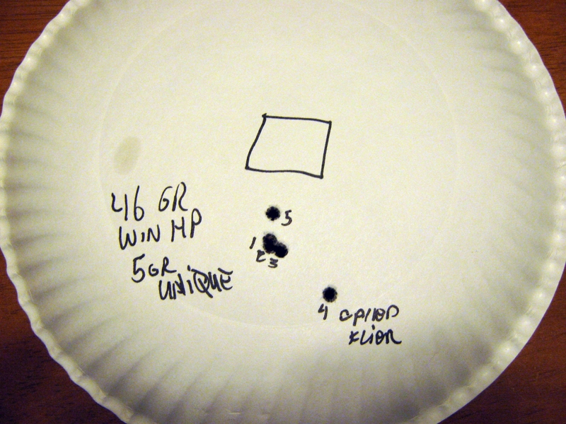

Well the full house loads won't be for squirrels.  Mainly ground hogs and possibly some yotes, albeit they are pretty cagey around here.  I did get to test all 50 I loaded last night today after church.  Had fun with the old man and he spotted for me.  I really like the scope for close in work, but at 100 yards, it has pretty thick reticles and they completely cover the 1" square, so I wasn't really getting fine tuned groups.  I think I might move it to my .22 LR Bolt which is scopeless currently since I stole it for my Model 60. :o   Gets hard stealin from Peter to pay Paul.  lol  Anyway, the low power ones all were pretty decent albeit all the 4 gr Unique loads had some vascillation vertically.  Not from heat, because it was like every other shot and not consistent.  Anyway, the barrel really like 5 gr. Unique with the Winchester the best for light jacketed (Yay, have 500 of these) and it did good with the 55 gr. Nosler Ballistic Tips at 100 also.  Using Reloader7 for about 3k FPS per Alliant's data and of course it did best right at near max load.  I'm going to do a second set of ladders with 4.6 to 5.5 gr. Unique in .1 gr. increments and probably go 19.4 to 20.5 (max) and see if any tighter groups appear.  If not, these'll probably be the ticket.  I'll be taking them to chrony when a day comes my buddy can set it up.  I am quite happy though, albeit was racing rain and I think a lot of the groups could have been better with good rests (not elbows and a cardboard box) lol.  ;)

Looks good! Are you noticing any "powder positioning" issues? How far does 5gr of Unique fill the case?
Thanks, Dinny
Thomas Paine
Offline tacklebury
  • Posts: 3633
  • Central Michigan
Re: .223 BC Scoped for Squirrels...
« Reply #13 on: November 13, 2011, 01:23:30 PM »
None at all Dinny, never lifted the barrel.  4 gr. load was the only one acting slightly erratic, so going to stay above that threshold.  Other than that, the 5 gr. was about 1/20th volume since I was putting 20 of RL7 and it was only 2/3 the volume.  I was very careful and charged all cases with no interruptions.  I look in each case for the shine of the bottom prior to dumping and pick up from tray on left and move to tray on right before throwing next charge.  Keeps things moving, but even if someone interrupts, I know I'm picking up on left only.  ;)  Estimated velocity on the 5 gr. load was around 1100 fps, but as I said it'll be chrony'd soon.  ;)

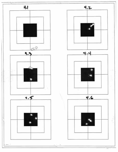

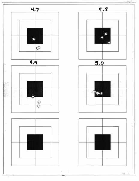

Well, here's the second to the last update on this post, hopefully.  ;)  I had good luck with the Unique and did stick with it.  I've loaded up a box o'death to squirrels in a ladder form from 4.1 to 4.9 and 5 more 5.0 unique loads.  Using the Win. 46 gr. HP again.  Hopefully will post targets tomorrow.  Going to do 5 per page I think.  Will possibly go for a squirrel too, if one offers itself up.  ;)  Possible rain though, so might be over Thanksgiving weekend.  Either way thanks for lookin' in again.  ;)  Found a couple of these nice little 50-shot MTM boxes for .223 too.  Very nice.  I added a piece of styroafoam from a packing container to the top to keep tips from bangin around and up.  ;)

Cool, I used Paco Kelly's .223 Cast discussion as a starting point.  All his unique downloads (although his were all 7gr) were rated very accurate to accurate in his testing.  He was just trying to keep speeds down to non-leading velocities, whereas I was looking for less.  I've shot my .45-70 with as little as 6 gr. unique with a RB, so I knew it was possible to go pretty low (pretty funny sounding like playdough dropping and then seeing that ball roll out the end of my 32" barrel was priceless).  Hopefully, I can get the chrony data up this weekend for what speeds each of these is getting too.  ;)

Ok returning to this post once more.  Will start a different post for future info on this project.  Long and short is that this is very accurate and got speeds down to the 1320fps range with 4.1 gr. Unique.  Cases do soot a good bit at less than 4.4gr. Unique, so not a perfect solution yet.  At 4.4 gr. Unique I was getting 1430 fps average, so more or less slightly higher than .22 LR High velocity rounds.  I am going to do another run, hopefully before squirrel season is over, and test from 3.5 gr to 4 gr with a dacron filler.  I may have to break down and try some of Dinny's TB also, but we'll see.  Anyway, just wanted to close this segment.  At 4.1 I got about a .28" group, so it's equal to many .22 LR for accuracy already, but a bit more powerful at 1320fps and a 46 gr. HP.  ;)
***edit***
Sorry, should have stated 4.2 was the lowest std. Dev. at just 10 fps. variance for an average velocity of 1340fps.  So that'd probably be the best load for consistency and it did shoot a good group.  ;)
