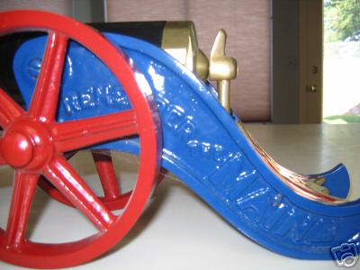

I'm alwas looking ahead 2 or 3 projects. I'm begining to like these breech loading signal cannons. I would like to cast something simular to one of these someday. It is a signal cannon that uses 10 gauge blanks. It could easily be scaled up a bit for 8 gauge:O) Does anyone have,  or can get, any good pictures of one? Or any thing simular? Thanks for the input, Wes

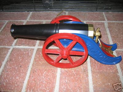

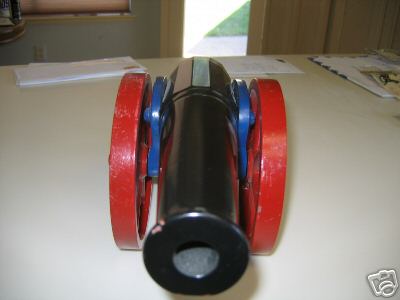

                    Some photos of a 12 gauge signal cannon, that appears to be a reproduction.

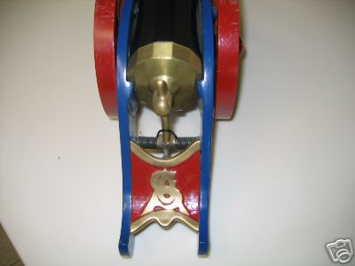

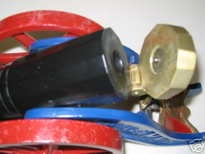

I am thinking of making some of these. The door has been a mistery to me? I couldnt figure how it was kept shut? But thanks to Boom J I can see that there are some lugs cast into the frame that hold the door shut. Thanks, so much for the pictures. Any idea how big this baby is? How wide are those briks in the background?

       I checked my pc photo file again. The seller's description was; A b-p 12 gauge blank firing signal cannon. Barrel 10.5'' long. He didn't say anything about it being a reproduction. It sold for $980.00 The 980 amazed me even more than the way the breech was held closed.

The barrel looks like it is not origonal? Maby it had problems? That would make the wheels about 5" in diameter then. I'll start drawing it up soon and see what I can come up with. Thanks for the pictures Boom J. I never could quite figure out how that damn door worked.

How about that firing mechanism! Spring wound slap hammer. Just thumb it back and let go.
Sorry;
But to have to thumb this thing to set it off is much to dangerous for me to want one. It would place my fingers, Head and hand to close to this cannon’s firing mechanism, and short barrel to be safe.
